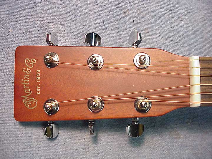

Sorry to rehash this but the spacing recommendations seem no where near the peghead I have or the pic below. The spacing at 1 1/2" leaves a LOT of room at the top and bottom of the peghead and it looks like the pic is closer to 1 3/4" - 2" apart.
Also the 2 E strings are closer to the edge than the other 4. It even looks like all 3 tuners have their unique spacing from the edge.
I can't find my Martin template, nor a template or measurements on line, just sold my Martin dread, and can't start drilling without some more info.
Does anyone have a Martin standard peghead or maybe a bit more info on actual measurements before I make a large mistake?
Larry

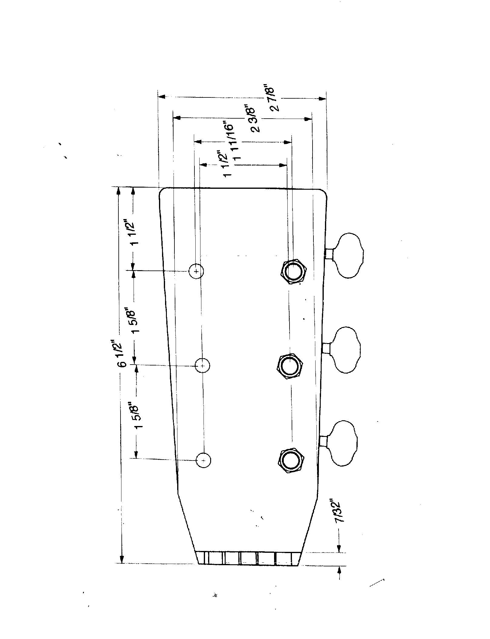

Found my template. Hope this might help someone else.
Larry
